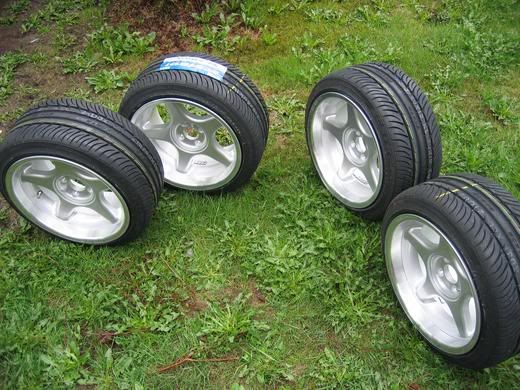

th_1112000-bilde1-img_1386.jpgp><p>[img]<a href=http://i22.ebayimg.com/02/i/07/70/d2/b0_3.JPG' alt='b0_3.JPG'>
