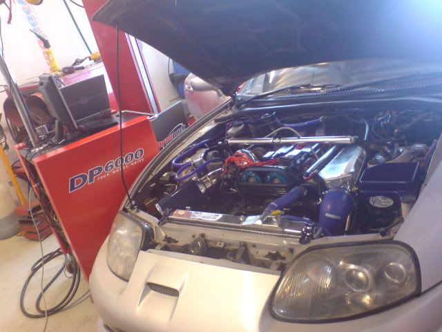

Litt specs på motor!
2 JZA 3.0
OVERBORE 0,020
WISECO STEMPLER
EAGLE RÅDER
268 EKSOS/INNSUG KAMMER
TITAN JUSTERBARE KAM DREV
MAP ECU 2 (MULIG BYTTET UT MED ELECTROMOTIVE SPRUT?)
TOPP OVERHALT AV CYLMO SKIFTET ALT AV PAKNINGER
BOOSTWERX INNSUGSMANIFOLD
90 MM SPJELL HUS
3" INTERCOOLER RØR
GREDDY COOLER
BOOST LOGIC EKSOSMANIFOLD
HKS 50MM WASTEGATE
VRP76DBB TURBO (950 HJUL HK) GARRET ALL THE WAY, BYGD OPP I USA
HKS TWIN IGNITION
850 HØY OHMS DYSER
2 X WALBRO PUMPER
8AN BENSINSLANGE 6 RETUR NY 8AN TUR SLANGE PÅ TUR. BACKUP FOR E85
MALLORY FPR (BENSINREGULATOR)
STØRRE FUELRAIL, MED 2X TUR OG SENTER RETUR
KOYORAD (KOYO) RADIATOR
AAP VIFTE KIT. DOBLE MED CHROM DEKSEL FOR RETT FLYT
PROFEC B SPEC 2 ELEKTRISK TURBO TRYKKSREGULATOR
GREDDY TURBO TIMER
INNOVATIVE BREDBÅNDSLAMBDA
V160 GIRKASSE (KJENT FOR Å TÅLE JULING)
SPEC STAGE 3+ CLUTCH GOD FOR 1150 NM GARANTERT ELLER NY TILBAKE FRA LEVERANDØR
RPS SVINGHJUL
WOTM CLUTCH LAMELL, RPS TRYKKPLATE OG RPS CYN R G I RESERVE. GOD FOR 900 HJUL HK OG 1000 NM
DETTE ER LITT AV DET SOM ER BRUKT ALLEREDE, FORUTEN EN DUNGE INSTRUMENT ++
