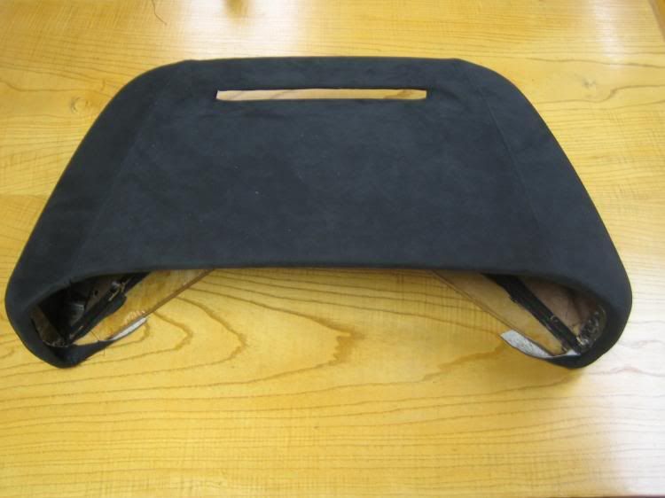

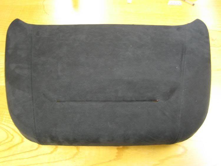

As the dash instruments mounting had been pretty much done, it was time to finish the dash pod. The rake of the windscreen on the Esprit is quite shallow and so the leather on the old pod is a nightmare for reflections from sunlight and street lamps. To get around this I will replace it with black Alcantara.

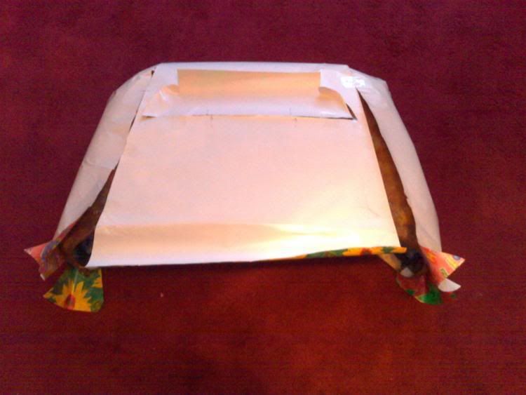

My first attempt was a dismal failure as the pod is a complex shape with lots of internal and external curves. The Alcantara I bought is foam backed and not very stretchy and so bunched up in a load of places and looked a total mess. The only way to get this to work was to peel off the backing then cut and tailor the material to fit. Sewing machines are way out of my league so I tricked my mother into doing it
Papirmal

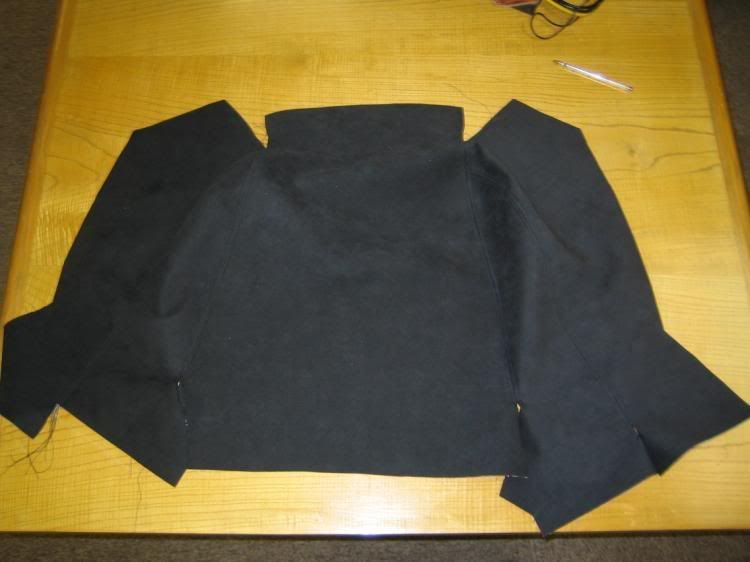

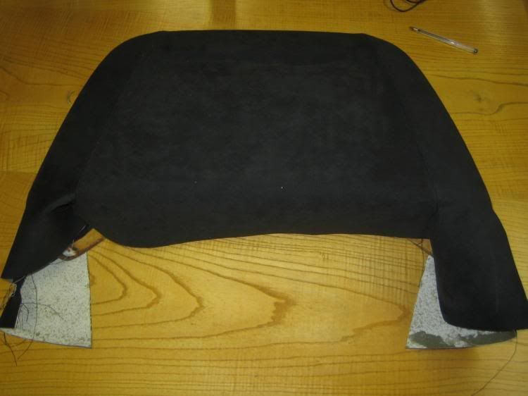

The paper was then removed, the Alcantara cut around it and then sewn together with double stitched seams.
After many hours of sweat and tears, my mum handed me this.
OK, time to bite the bullet and stick it on with contact adhesive.

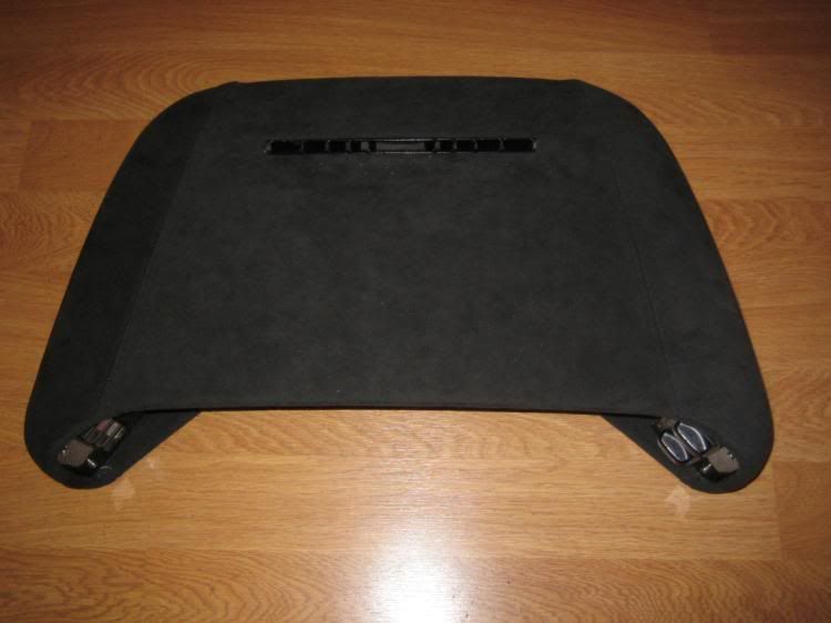

Looking good so far, phew!
A bit more stretching, pulling and gluing and this is what I end up with.

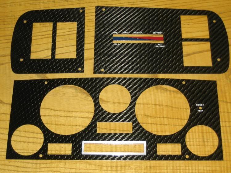

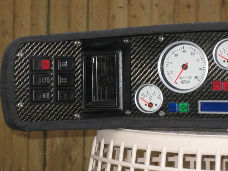

Next back to the carbon fibre faces. The side panels were cut for the switches and the heater control graphics painted on.
I also made a bezel for the alphanumeric LCD display to balance out the gauges a bit.
So here is what the finished article looks like.

The switches and face vent.

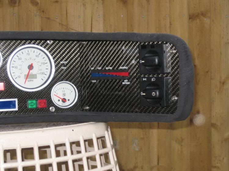

The heater control and light switch

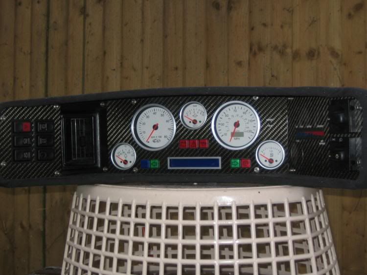

The whole thing.
The lurvley McLaren carbon fibre is a real pain to photograph as the twill reflects the flash, so I had to take this at an angle.
One final shot of the finished thing with the screen demister vent fitted.

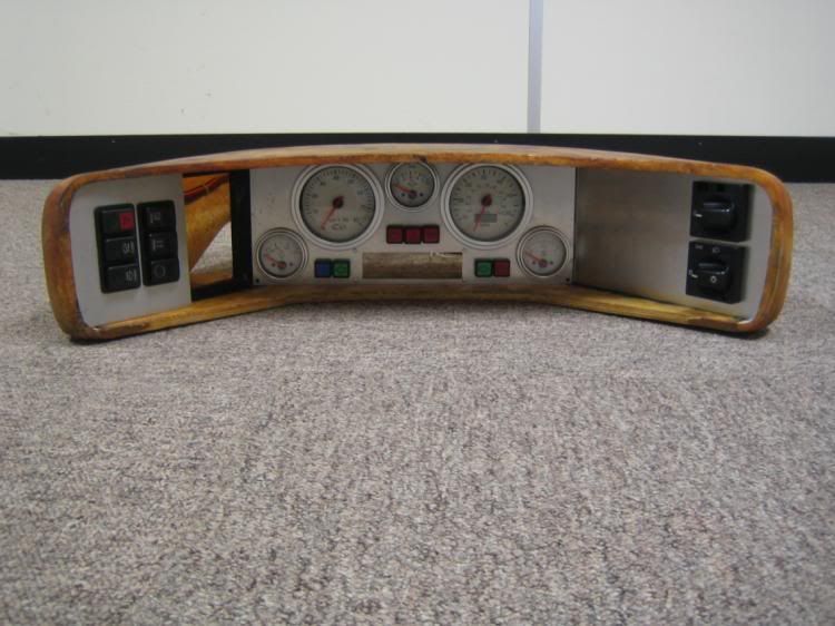

Utgangspunktet. Dog med nye instrumenter
