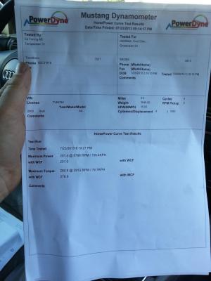

268hk i motor*
374nm

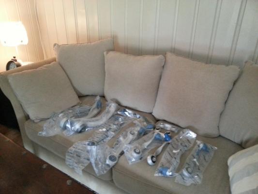

Forstilling kitt + foringer
