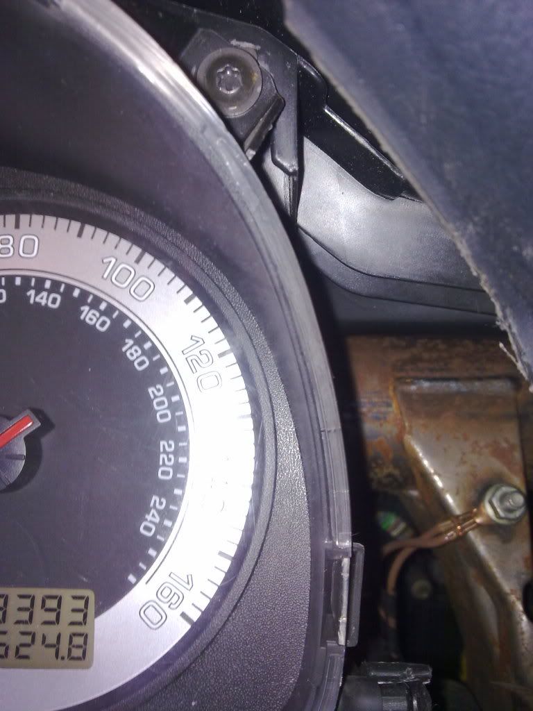

the cluster is secured by two more T20's and two clips. unskrew the T20's then lean the cluster forward and gently pull it out of the clips.

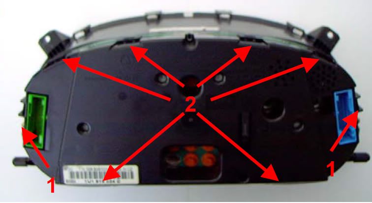

to open the cluster unskrew the two T10's marked with 1 then unclip the plastic clips marked with 2

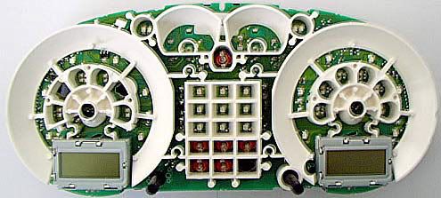

there's no need to cut any plastic (as seen in countless other guides). on the backside you'll find metal clips that hold the displays in place. twist them with the pliers, remove them and remove the displays. it's time to remove the plastic grid. start by pressing the clips on the back, then pull the grid out.

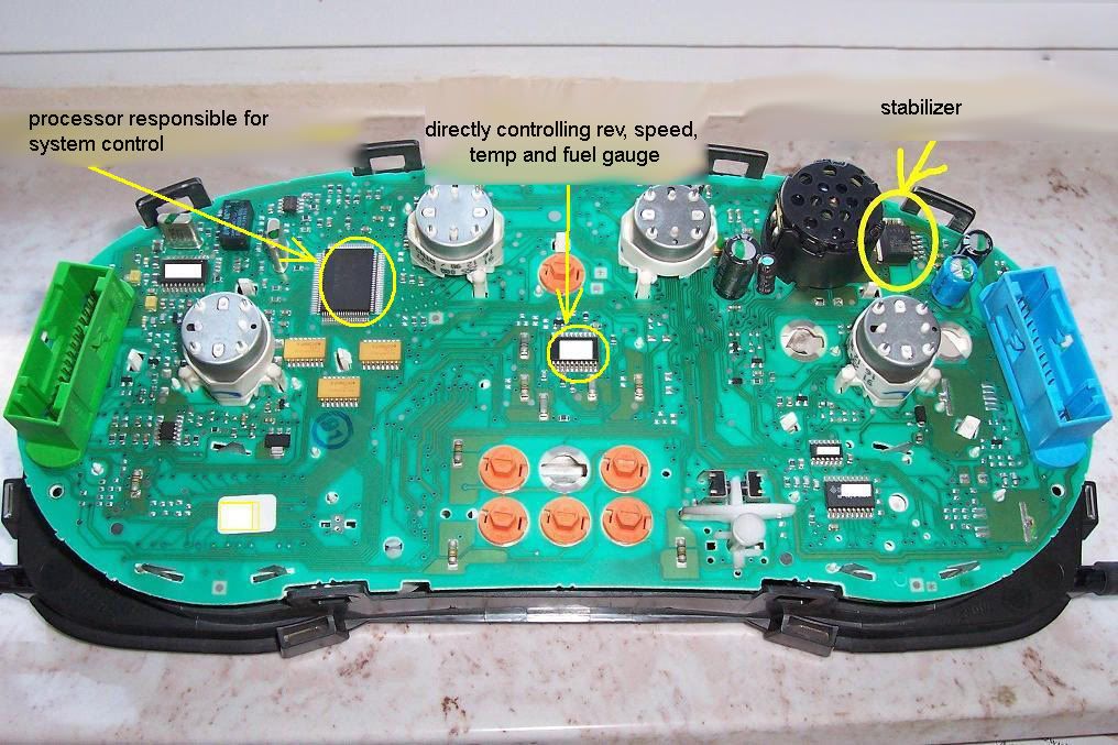

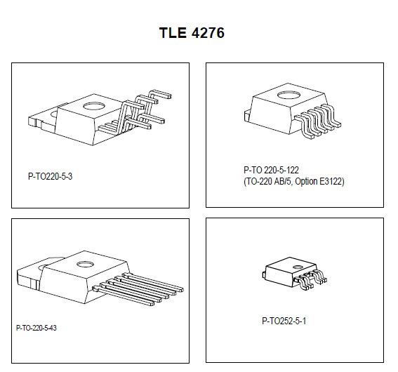

we now have a naked circuit board. time to go hunting. we're looking for a TLE 4276 voltage regulator and a resistor bridge in particular. (any other joint that looks fishy is to be inspected and soldered as well). board designs vary, whilst a fellow briskoda member sent me this "diagram" which i translated from polish, mine was completely different.

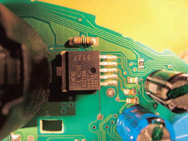

the stabilizer (TLE 4276) may look like this.
generally it's located here: (mine was between the fuel and temp gauge, surrounded by a metal housing)

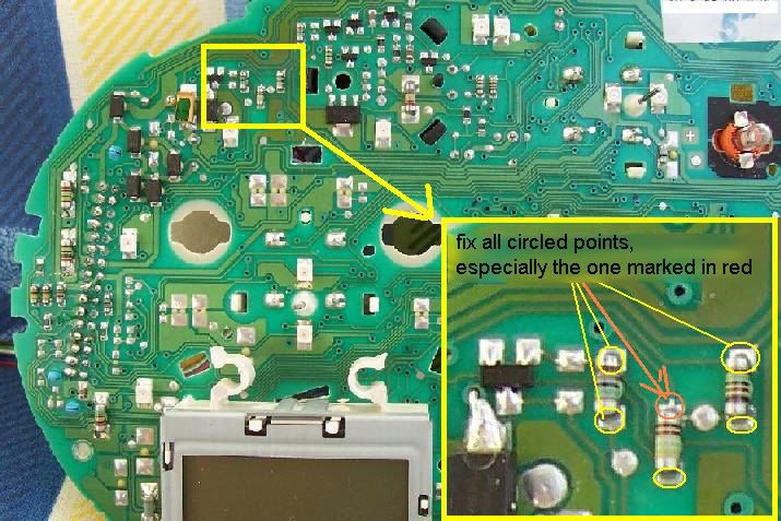

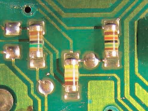

the resistor bridge we're looking for: (image from the same polish forum, translated via google translate) (ignore the fact that the displays are here still in place)
solder the pins and connections highlighted (TLE and resistor bridge), look for any fishy connections and solder them to.
i'we soldered all the harness connector pins and various other joints and pins just to be on the safe side. besides, a capacitor fell of my board the minute i removed the white plastic cover... now that's some quality work VAG...
